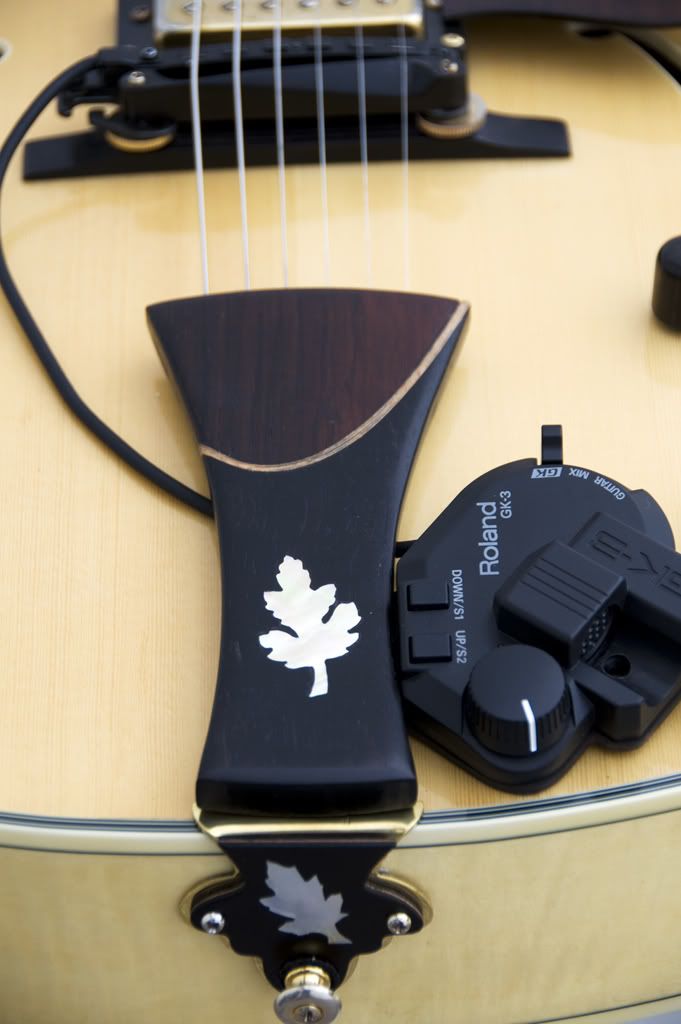

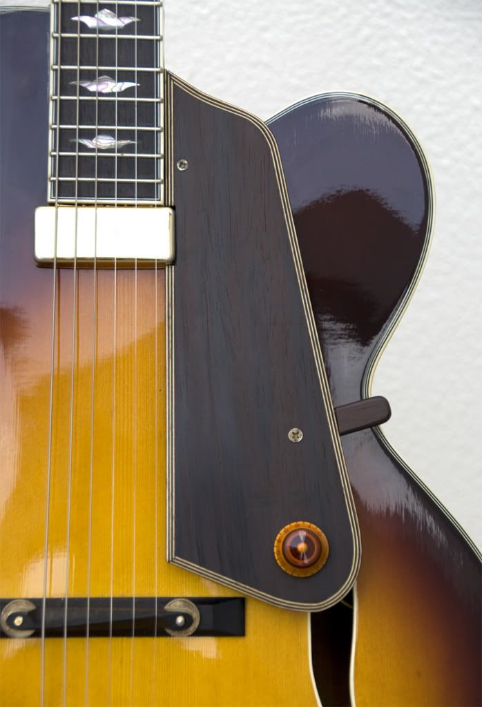

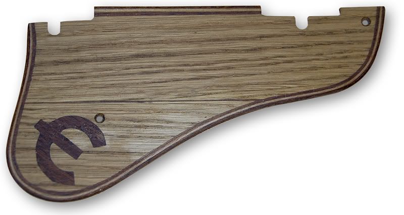

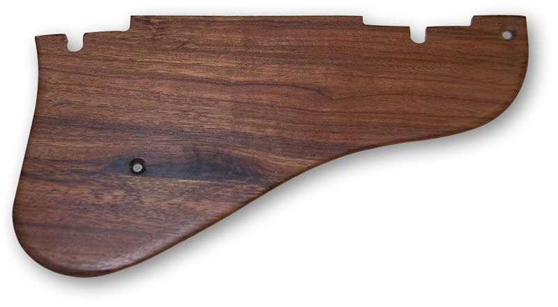

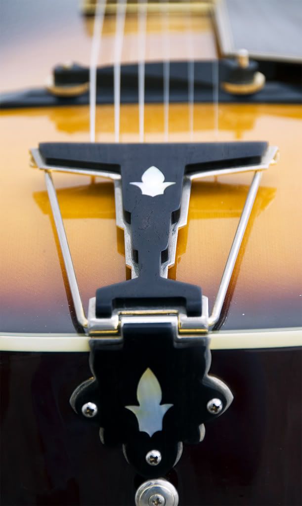

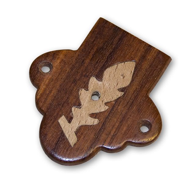

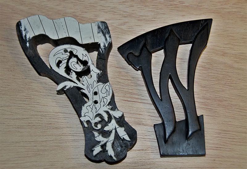

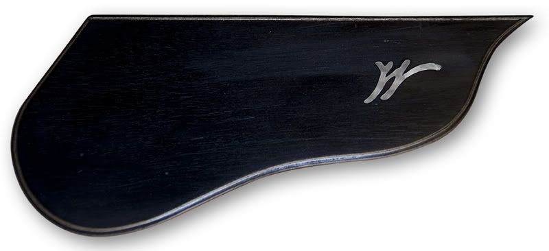

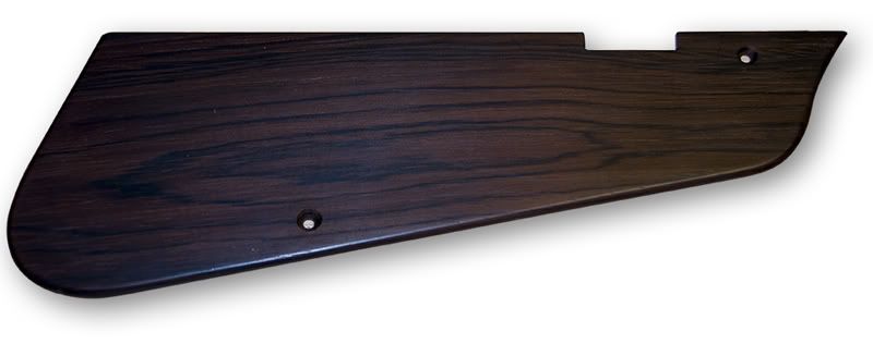

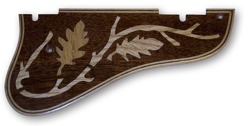

These are some of my small work, if I call it so!!!
Picguard for my Washburn J9
Inlaid Tailpeace for the Washburn J9
Inlaid Tailpeace and Roland GK3 adapter for my Epiphone Joe Pass
Some tailpeaces half done
and other stuff

Your other pieces (bridge, tailpiece, etc...) are impressive :shock:
I really like their look and their design.
Great job, show us a lot of new photos !!
